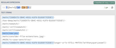

    I've tested the ^\/main\/\w+-[\w-]+\/ syntax in example below, see what matches by yourself
