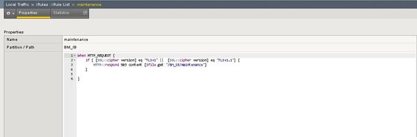

Hello,
Kindly note that the following irule was applied on VS but its not working properly :
when HTTP_REQUEST { if { [SSL::cipher version] eq "TLSv1" } { HTTP::respond 503 content [ifile get maintenance] } }

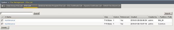

As per the below ifile exists and verified on cli : As well on firefox im forning to use TLS v1
[root@f5-IB-1:Active:In Sync] config tmsh list sys file ifile sys file ifile maintenance { checksum SHA1:714:28de1ccd8407b517163fdcdc352ae847f46df53c create-time 2018-01-09:10:07:18 created-by admin last-update-time 2018-01-09:10:07:18 mode 33188 revision 1 size 714 updated-by admin

  • Hello Abouleil,
    Try the following code
    when HTTP_REQUEST {
        if { [SSL::cipher version] eq "TLSv1" ||  [SSL::cipher version] eq "TLSv1.1"} {
            HTTP::respond 503 content [ifile get "/Common/maintenance"]
    Verify that your ifile is under the "Common" partition or replace "Common" by your partition name.
    Regards

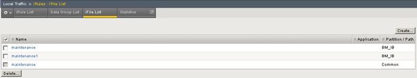

  • Think you will need to create an LTM iFile object as well, the sys file ifile is used to import the file into iFile but reference for use is through ltm
    The following on TMSH should create the iFile for reference within an iRule:
    create ltm ifile maintenance file-name maintenance
    Or on the Web GUI:
    1. On the Main tab, click Local Traffic > iRules > iFile List.
    2. Click Create.
    3. In the Name field, type a new name for the iFile, such as ifileURL.
    4. From the File Name list, select the name of the imported file object, such as 1k.html.
    5. Click Finished. The new iFile appears in the list of iFiles.

    I thing you juste forgot to reference your Ifile in LTM. Go to Local Traffic, Irules then "Ifile list" then create your Ifile reference with maintenance name...
