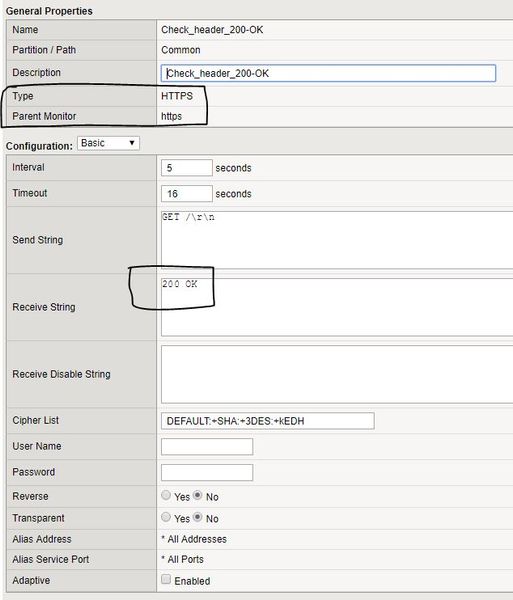

      Still failed. No clue what going wrong here.
      My monitor setting as below:
      Node setting
      Pool setting

      Could you change your node monitor to gateway_icmp and remove https_443 from the pool so you're only using the Check_header_200-OK monitor

    You need specify the HTTP version in your send string if your backend does not support HTTP/0.9:
    GET / HTTP/1.0\r\n\r\n
  • Create a http monitor with alias port 80
    send string:
    GET / HTTP/1.1\r\nHost:\r\nConnection: Close\r\n\r\n
    Receive string:
    HTTP/1.[01] [23]0[0-6]
    And enable it on your pool (please remove the other monitors)
