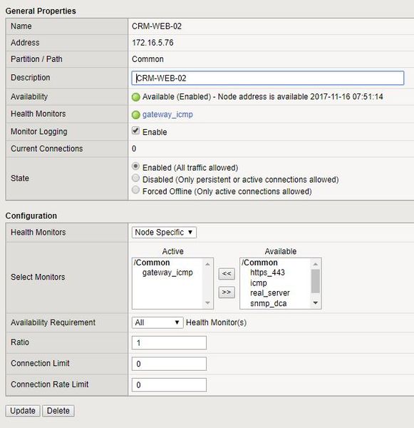

- Lee_SutcliffeNov 16, 2017
Nacreous
Could you change your node monitor to gateway_icmp and remove https_443 from the pool so you're only using the Check_header_200-OK monitor
- Shamsul_Alam_34Nov 16, 2017
Still same after changed the setting as you requested

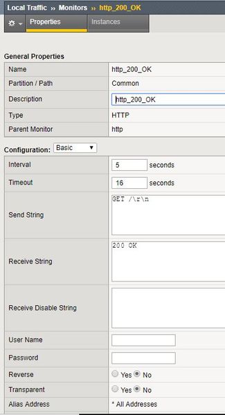

Nacreous
Just noticed the Curl command you ran earlier is using TCP/80.
Could you create an HTTP (parent profile http) health monitor, first without a receive string. Then with the receive string.
Thanks

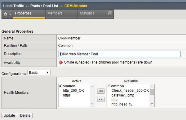

Still same. Monitor for HTTP
Pool
Nacreous
please remove https from the active health monitors
