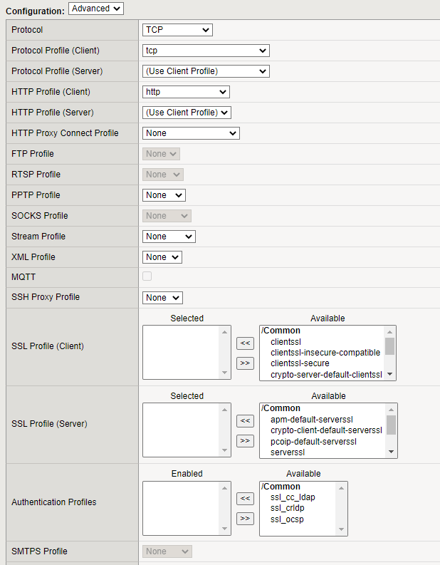

This is the Virtual server configuration: everything seems to be disabled.
- PSFletchTheTekApr 27, 2022

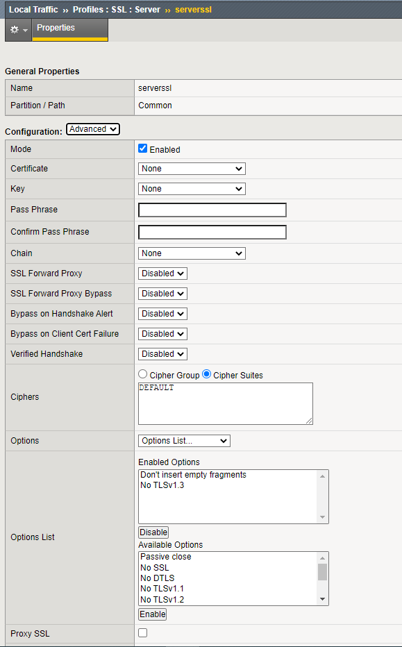

Hi,
Your in Local Traffic > Virtual Servers > [VIRTUAL SERVER] > Secuirty.
SSL Certs are set at
Under Configuration
SSL Profile (Client) and SSL Profile (Server)And these policies are set in Local Traffic > Profiles > SSL > Client or Server as needed.
Client is incoming so from web client to f5 and server is f5 to web server,
From the looks of your in i'm guessing this is linked to the f5 to server comms so the SSL Server profile is being used.So possibly something in the server ssl profile is stopping you?
You are in the range of looking at what updates have happened on the TrendMicro platform, and a f5 support call to try to deep dive into it.- MadMickApr 27, 2022

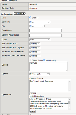

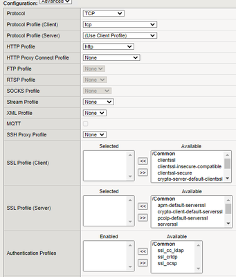

This is my configuration...and it seems correct: what do you think?
I already check this and I can't see any blocking parameter.
