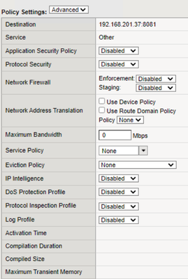

So where is this flow error coming from? AV to Virtual server? Or f5 to pool member?
Where is 192.168.201.37:8081?? I'm guessing this is a f5 to pool member flow?So to remove the encryption you just need to remove the client and server SSL profiles from the virtual server.
But there must be a way to check this, maybe even take a pcap of the flow and have a better look,
Possible f5 support could look at the config and that pcap for you with more understanding of what those errors mean.- MadMick4 years ago
This is the Virtual server configuration: everything seems to be disabled.
