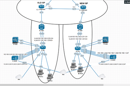

Hello everybody,
My company system now is located at one Datacenter and now my boss want to split it to two different Datacenters to achieve full redundancy ability for the system (hardware and...

If i do the HA configure for 2 F5s that have HA link connect by a Switch, they will work properly. At the moment i have 3 pairs of A/S F5 in my old Datacenter.
Summary in my case, the F5 in old datacenter can not make TMM connection with the F5 in new datacenter via L3 connection. This make CMI flap every 5 seconds. Has anybody successfully did HA for a pair device through L3 connection yet?
