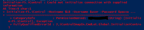

Recently i have upgraded my F5 device to version 14.1.2.3. Post upgrade, everything is running fine without any issues, except few power shell scripts. Application team is getting permission denied error under script. I checked everything, and user have appropriate permissions. And on other F5 instance which is having 13.x version, script is running fine with same user. I am actually stuck and not able to find anything.
Did you face any such issue? any help would be appreciated!

Thanks for your response. Yes this may help me. Let me check with application team, i'll also check few things under script. Just to give more clarity about error that we're getting, sharing error snap for your reference.
Hey John,
Error that i observed was a bit different. Here in above snap, i see it is straight away giving permission denied error. I would recommended you to again cross verify login creds and access level. Also have you checked these login attempt requests on F5? Please see it under system-->log-->Audit

Issue resolved. I had rebooted my F5 device and post reboot, script started working fine. It seems some of the services were not up post upgrade and those services were causing issues while executing script.
