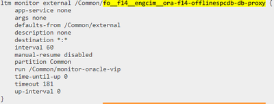

I set up the oracle external monitor will suddenly fail, manually build a similar test but normal again.
Here is monitor setting
Today, I changed back to the original monitor and it is normal again...
