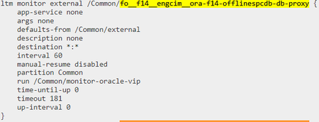

Nov 10, 2022pool monitor issue
Hello, I encountered a problem here... I set up the oracle external monitor will suddenly fail, manually build a similar test but normal again. Here is monitor setting Today, I changed back...

Nov 11, 2022Hi CA_Valli,
Thanks for your aply.
But I find it odd that a node with the original state of down actually UP after switching to another monitor with the same settings...
And it also happened three times...

Nov 11, 2022As long as your script retrieves anything an answer (so that there is some data in stdout output), external monitor will mark node up... let's say it returns a "KO" message or "connession issue" messege -- those are both non-null strings so monitor will be green.
