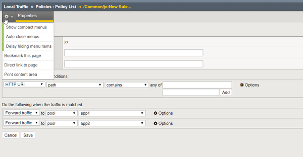

      Maybe you can try this with ltm policy? It has lot of simple gui config compared to writing irules.

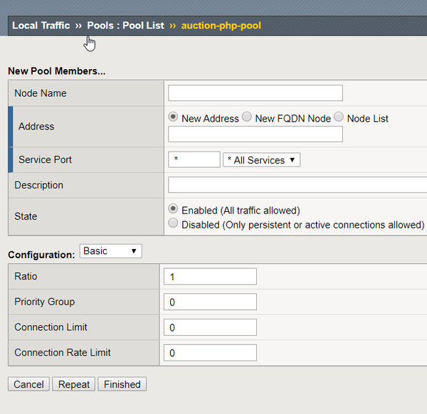

      Well you can just leave the pool member ports to ALL SERVICES.
      And create an irule which will only allow connections to your allowed range of ports and reject everything else.

      Its just 1 server listening on multiple ports right?
      So whatever the uri and ports comes in should be responded to by the member as the services are set to all .
