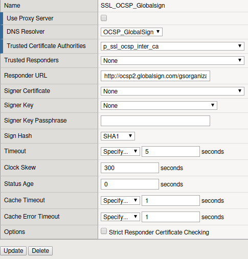

Here is my OCSP Config :
Finally configure OCSP Stapling profile on my SSL profile

  • Can you send a screenshot of your OCSP Stapling config, or describe how you've configured it?
  • Okay, so maybe two things:
    Trusted Certificate Authorities : p_ssl_ocsp_inter_ca --> Certificate who contain Intermediade Globalsign Certificate
    This needs to be the complete CA chain, not just the immediate CA signer.
    Clock Skew : 300s
    Can you also verify that your time is in sync?
