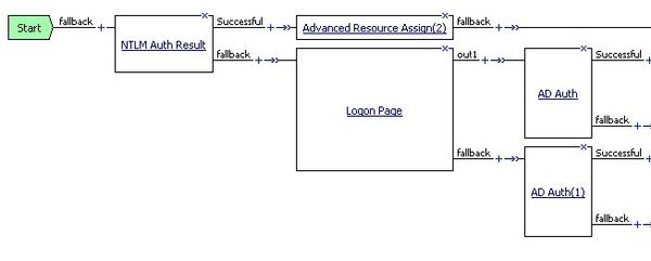

Hello everyone,
I've been trying to configure an APM policy to authenticate the users transparently via NTLM as long as the user's computer is Joined to the domain else they should be shown the Logon Page. I've followed the guide from kevin (https://devcentral.f5.com/articles/configuring-apm-client-side-ntlm-authentication) and NTLM works fine (The VS has the irule for NTLM indicated in that post too). The problem comes when the user access with a non-domain joined computer, the browser keep asking for credentials (Pop-up).
As per my policy the fallback path for NTLM connects with Logon page, although that Logon Page never comes. If i write down the correct credentials i will not be prompted again for them but the page displays an error (Can’t reach this page) and if used NTLM with a joined computer it will be accepted.
Thanks in advanced
7 Replies
  • Hi,
    the issue is client still try to authenticate because of 401 response.
    NTLM auth is done before Access policy is evaluated, so it never follow fallback branch.
    NTLM auth result is not a NTLM auth action but a validation of NTLM auth performed at LTM level.
    try with following code to disable NTLM auth if first attempt fails.
    when ECA_REQUEST_DENIED {
       log local0. "User [ECA::username]@[ECA::domainname], Client Machine [ECA::client_machine_name], Auth Status [ECA::status]"

      a first step would be to explain how exactly your situation is the same. how does your policy look? and what of the tips here you already tried.

      at least from other posts on devcentral, it looks like this may not be possible as NTLM auth happens before the policy starts. So the only workaround is to check for domain membership beforehand, but that requires edge components to be installed and I'm hoping to avoid installing edge components company wide.

      have you read and tried what Stanislas Piron posted? he suggests a method to handle to issue with NTLM happing before the policy.
