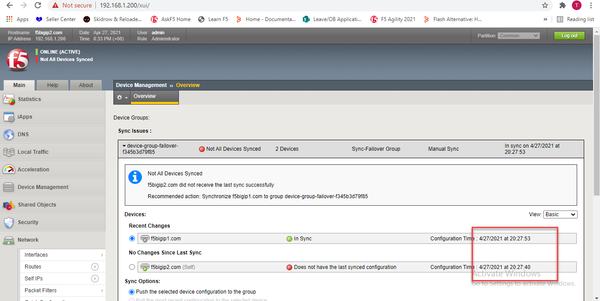

Not all devices synced?? Please help me i'm new on using F5 TIA :)
I actually planning to create an HA for both of my BIGIP servers.
Issue:
  • Not all devices synced
  • The time for my 1st and 2nd Big-Ip doesn't matched even though they have the same time-zone setup as Asia/Singapore.
Note: I don't know how to setup my NTP server, I just used the IP of my test server as NTP
Regards,
Renato Alcala

  • you can force config sync from tmsh with command ( run cm config-sync force-full-load-push to-group <group name> )
    this command will push configuration from device you are logged on to group

      hi  ,
      I already done executing the command but still nothing happens 😞 .. Thanks for the reply sir.
      0691T00000CnhInQAJ.pngRegards,
      Renato
