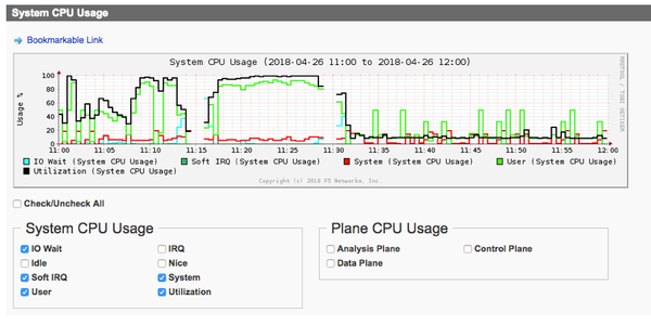

I was doing the elimination of learned traffic, elimination of the suggestion of some violations, when unexpectedly the machine is locked in GUI blocking and additionally is placed in "Offline" mode causing failover, additionally a high CPU consumption is observed over 100% Once the theme is reestablished, the ASM policy generates access blocking to the associated Virtual Server, and as a solution to this, the ASM policy "policy_new_www" is restored, restoring the service.

  • to me it seems that your actions led to high cpu and memory exhaustion, the last one causing the mysql process to crash. that crash causes a ASM failure, which causes a fail over.
    please make a qkview while there is still enough data and open a ticket with F5 support, this should not happen and only they can point you to a probable cause.
