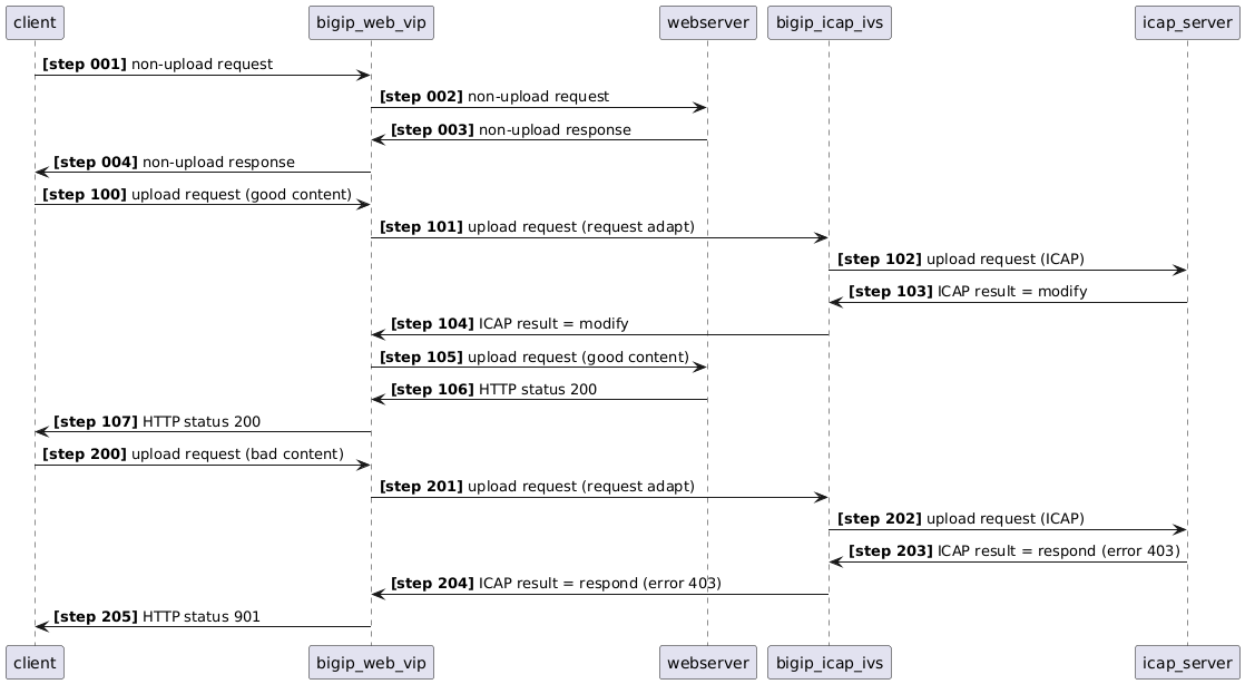

I'm facing the following problem with an ICAP setup: What we want is AV scanning of file uploads to a web page using ICAP on the BigIP. This is done by using a request adapt profile in conjunction with an internal virtual with ICAP profile. We want all POST requests to a specific upload path to be sent to an ICAP server that performs AV scanning. When finding an infected upload, the ICAP server will respond with an ICAP result "respond" (instead of "modify") and return an http 403 error page (we cannot change that behaviour). The upload (POST request) will not reach the webserver in that case. Up to that point, we could get all of this working properly.
Unfortunately, the client application (third party product) will throw an unexpected and undefined error upon receiving an http 403 status code. In order to display a meaningful error message to the end user, the application expects an http status code 901 instead. As already mentioned, we can neither change the http 403 error returned by the ICAP server (third party product), nor the need/expectation for an http 901 status by the web application (also third party product). Hence, we plan to rewrite the http 403 reply (of the ICAP server) into an http 901 status on the bigip, resulting in the following setup: click here
