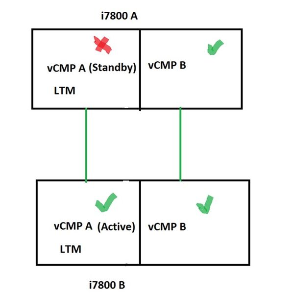

There are 2 i7800 v15.1.0.4 chassis running, each with 2 different guests connected to peers on the neighbor chassis by HA-failover configuration.
The problem arises with Standby vCMP guest, which works in HA pair with a vCMP guest on a neighbor chassis with identical config. The modules and resources provisioned (LTM is enabled) are the same, the load is small, swap is not used, SMART was successfully passed. On the active device paired with the problematic one there are more or less the same messages in logs - nothing critical and there also exist a bot user that logs in ~ 3 times / min and no problems with management are noticed.

Can you tell me where to search, please? I will be very grateful, I do not know what the problem might be if everything is the same, and the problem does appear on 1 device out of 4.
