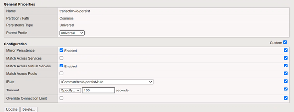

Explaining a bit about scenario. Customer has requirement of sending certain traffic to specific node within a pool for 2 different URI with same transactionID (attaching snapshot for 2 sample transcationID) . The objective is api /req and api /resp should land on same node. Below irule seems not working as expected. the below irule is attached to persistancy uie and attached to vs.

In the snapshot 10.20.210.22 is selfip and 10.20.19.99 / 100 / 101 are backend servers. Objective is if transaction ID is same for both api (req and resp) , it should always land on same node.

- Amith_Rajgopal_
Employee
Thanks Daniel for response.
I am under impression persist add uie is to be used for http_response and we are not inspecting response of the server.
Am i going wrong in my understanding?
You are right with your understanding, it must be inserted as part of the response.
- spalande
Nacreous
Can you try configuring oneconnect profile with /32 mask and see if that makes a diffrence? With oneconnect, F5 should detach the connection and reload-balance using persistence record per HTTP request.
- Amith_Rajgopal_
Employee
Sure Sanjay. I will try Oneconnect too.
