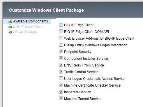

we want to use the machine tunnel to just connect the clients wit split tunnel to some license servers.
I installed nearly all components and set up the tunnel in registry.
Machine Certificate/Info is not working and there is created several apm/ltm sessions.
Is there more information about troubleshooting/configuring machine tunnel? Is someone successfully using the machine tunnel without edge client?

Thank you ver much for your reply.
Always connected mode is not in use - cause we want to use only machine tunnel w/o the edge client...
Is that even possible?

The ressource assignment is working and the client with machine tunnel is getting Access_Policy_Result=LTM APM_Mode;"
Every minute there is coming a new session - and the client can't reach anything in the tunnel
