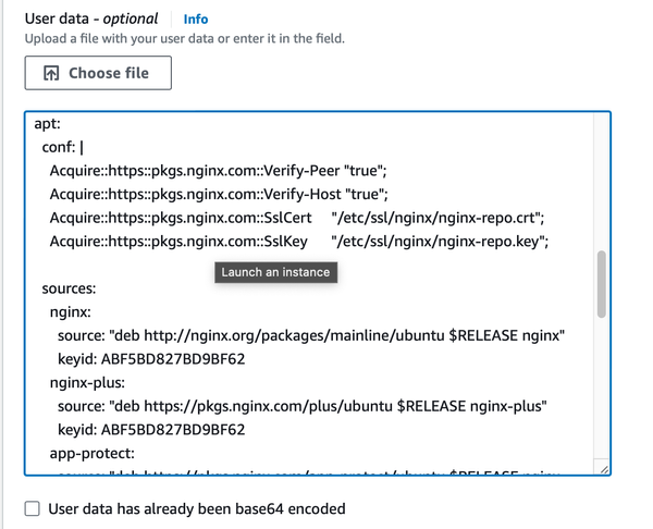

On AWS EC2 using the Web UI
When using the Web UI to launch a new instance, click on Advanced Details at the bottom of the page. Scroll down until you see a section labeled, "User data - optional."  You can either paste your YAML into the box provided or click the "Choose file" to upload the file from your computer.
