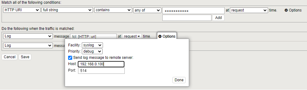

Hi
Can someone explain to me, what im doing wrong.
I have a policy attached to a Virtual-Server, and it is triggered when a specific URI enters.
There are two actions, one that logs a message to local logfile, and another that logs to a remote syslog server.
I can see that the actions are triggered because my message is writen to the local log file, but nothing is sent towards my syslog server. I have verified it with TCPDUMP that nothing is leaving the management interface, and I have also tried with different hosts and ports.
This is the policy i created.
Regards
Christian

      In this case I use "Route Domains" for all other communications, so "list net route one-line" is empty.
      Mgmt interface had a "default route", but to be sure that nothing had better route then that I added a /32.
      Once in a while I get below error message, and initially i thought it was remote syslog server that "rejected" the packages but as I said in before I used TCPDUMP to see if anything exited the Mgmt interface but nothing did.
      Error in log file:
      Execution of action 'log write port=514 message= facility=local0 priority=info ip-address=192.168.0.100' failed, error ERR_REJECT
      It is possible that packages leaves the loadbalancer on some other interface, but I had TCPDUMP listen on all other interface and did not see udp/514 packages on any of them.
      And forgot to say that i can  PING syslog server from LB, and that package leaves on Mgmt interface.
      /C
