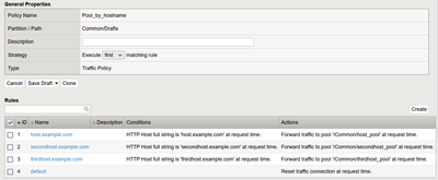

I am looking for some advise for setting up a F5 Big-IP that can accomplish the following things.
I only have one public IP address but will be hosting muliple services. I am looking at setting up one VIP that's open to public with ports that are required then when hitting FQDN that it redirects to VIP that is hosting service. Example mysite1.domain.com goes to VIP 10.10.10.100, mysite2.domain.com goes to VIP 10.10.10.110, so on. Is this done by iRule, reverse proxy, or policy. What's the best pratice for setting something up like this. Thanks in advance for the help.
You need a first match strategy here. And while it is technically possible to forward to another VS, forwarding directly to the pool member is sufficient here unless you have reasons to forward to a secondary VS.
The flow is: client --> VS (with policy attached) --> pool (selected by policy)
Example:

Hello Amine,
Could you give me an example?
I have tired setting a polices "Match all... HTTP Host>host>is>any of>mysite1.domain.com>request". Then "Do the follow...Forward traffic>virtual server >"VIP I created>request. I am trying to figure out how to create another rule that when it hit "mysite2.domain.com that it goes to the correct pool.
My thought process is this. VIP that's accessible externally, then it redirects it the correct pool but I am lost on creating a default rule that denies traffic or forwards it to a default pool. Thank you for the help an explantion. I'm trying to wrap my head around F5.

Try searching for f5 vip targetting vip.
In theory you should see this,
Vip Targeting Vip Solutions - YouTubeIt's basically what you are trying to do.
A LTP (local traffic policy) is all you need, linked to a front virtual service. That hold your extneral IP.
And then internal virtual servers are linked by that policy.
when creating the internal virtual servers they need a IP, that can be any ip it doesn't need to be routable/accessable if you don't want it to be, But you can't create a Virtual server without a ip. You need a first match strategy here. And while it is technically possible to forward to another VS, forwarding directly to the pool member is sufficient here unless you have reasons to forward to a secondary VS.
Example:
Hi,
This is not an uncommon scenario. You can have one public IP and use it for a bunch of applications as long as you use different hostnames for your apps.
The best solution here is to use a local traffic policy which checks the HTTP hostanme and forward the request to the relevant pool, one rule per application, plus a default rule which either denies traffic or forwards it to a default pool.
Note that in this scenario you don't need to use different ports for your published apps, because the differentiator is the hostanme. Also whether your public IP is on your firewall (NATed to F5 vip) or directly configured on F5, this also doesn't matter.
