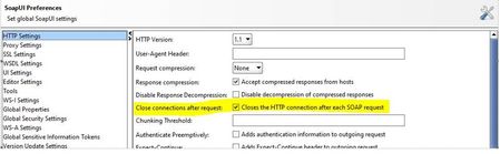

You have a Fast-L4 virtual. This is TCP connection oriented, so there is only one load-balancing decision made per TCP connection.
As per your screenshot of the back-end service, it allows long-lived TCP connections that will accept multiple HTTP requests on that single connection.
If you disable that option, then the TCP connection is closed after each HTTP request, and you get your expected request distribution.
If you want per-Request distribution, then you need a Standard Virtual (not Fast-L4) with an HTTP profile and a OneConnect profile to ensure per-Request load-balancing decisions.
