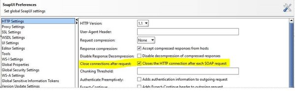

During Testing we have seen that connections is not load balanced within 3 pool members. It just goes to 1 node not distributed within 3 nodes. I believe traffic is initiated from One Source during testing. But even if traffic is generated from 1 Source it will generate multiple connections or it is sessions . How to distribute multiple connections/sessions even it is generated from 1 node ?
Interestingly if from Source Application it by force closes the connection ( attached application image ) new connections then distributed to 3 backend nodes behind F5.
Please advise what could be done to distribute the tarffic within all 3 backend nodes.

  • You have a Fast-L4 virtual. This is TCP connection oriented, so there is only one load-balancing decision made per TCP connection.
    As per your screenshot of the back-end service, it allows long-lived TCP connections that will accept multiple HTTP requests on that single connection.
    If you disable that option, then the TCP connection is closed after each HTTP request, and you get your expected request distribution.
    If you want per-Request distribution, then you need a Standard Virtual (not Fast-L4) with an HTTP profile and a OneConnect profile to ensure per-Request load-balancing decisions.

      Screenshot you see I attached , if that Yellow Marked Option is selected then I see connections are distributed within backend servers. If that option is not selected I see 1 single connection ( TCP Connection ) to Only 1 node. Screenshot says HTTP Connection I am not sure if that means TCP Connection or HTTP Connection. Confused actually.
      Assuming in the screenshot it meant TCP Connection , how does that work for HTTP Traffic once TCP Connection is closed. Sorry for my knowledge limitation.

        HTTP request/responses are (currently) passed over a TCP connection.
        A HTTP client (browser) can open a TCP connection, send an HTTP request, wait for the HTTP response, and then close the TCP connection.
        More commonly, the HTTP client will open a TCP connection, send an HTTP request, wait for the HTTP response, send another HTTP request, wait for the HTTP response, and then eventually close the TCP connection. This is called HTTP Keep-alive or HTTP persistent connection.
        The highlighted SoapUI option Close connection after request is actually referring to closing the TCP connection after the HTTP response, disabling HTTP persistent connection.
