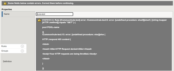

    Kindly when i deploy this iRule it shown me an error
  • Yep, there were some extra brackets. I edited previos message, try again.

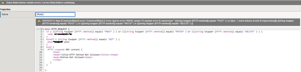

      Salam bro ,
      I am trying to test the script in testing environment but it shown this error to me :-
      Thank you in advance
  • Hello Ahmed,
    i guess there are some extra spaces between "}" and "elseif".
    when HTTP_REQUEST {
      if { ([string toupper [HTTP::method]] equals "POST" ) or ([string toupper [HTTP::method]] equals "PATCH" ) or ([string toupper [HTTP::method]] equals "DELETE" ) } {
        node XXXXXXX XX
        } elseif { [string toupper [HTTP::method]] equals "GET" } {
          pool XXXXXX
          } else {
          HTTP::respond 405 content {
       <html>
       <head><title>HTTP Request denied</title></head>
       <body>Your HTTP requests are being throttled.</body>
       </html>
    • Ahmed_Mohsen's avatar
      Ahmed_Mohsen
      Thank you it's accepted now ,
