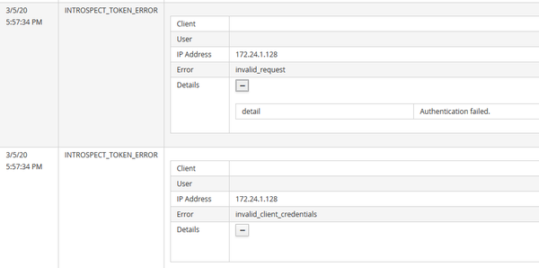

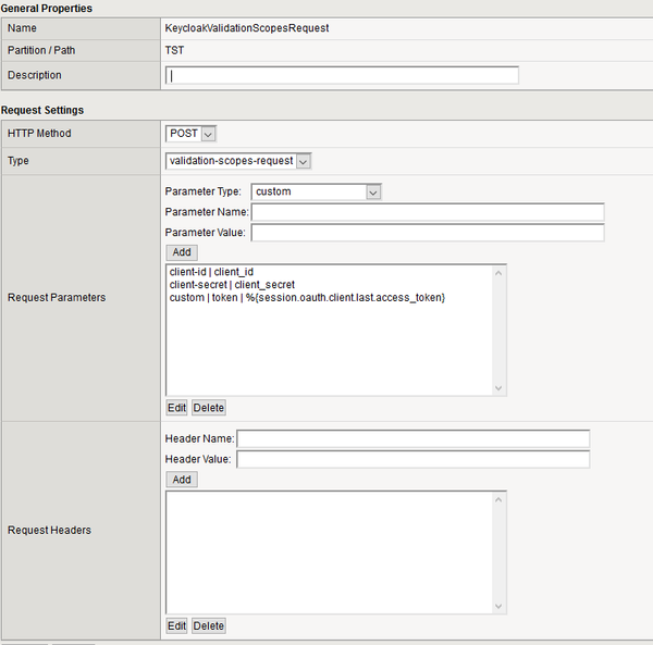

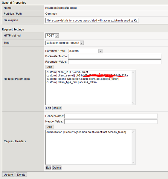

    but When I try to create a custom f5 keycloak scope request, I always have the same issue :  error: HTTP error 401, Error: invalid_request: Authentication failed.
    So I dont understand why ? i try to made tcpdump to see what exactly F5 send to keycloak but, not helped for the moment.
    I see client credentials error in keycloak logs :
    But double checked the parameters > same used in curl ...

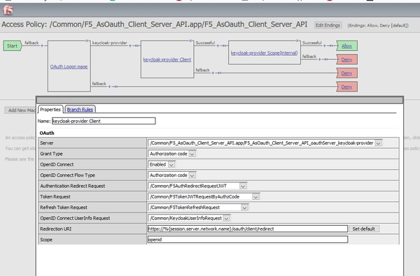

      We are using ou F5 APM as a full OIDC client, redirecting the user to IDP logon page, requesting token etc..
      Regarding the custom scope validation request, mine is more or less the same. Not so many params though, bare minimum only:

        And we see now that the F5 :
        • send %{session.oauth.client.last.access_token} in place of token
        • miss to send the client-id and client-secret parameters in the body
        • send to much useless info to the keycloak like dns resolvers IP, backend server IP, ssl profile....
        So I rebuild the request using only custom fields even for those by default like token, client-id...:
        and then now it works ! 🙂
