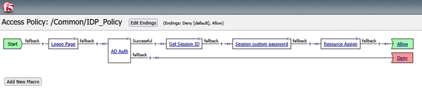

1.  On the IDP Policy

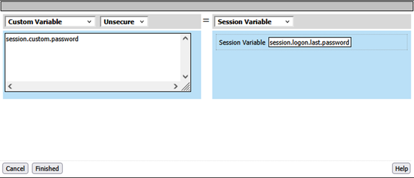

  • Create a custom session variable (e.g., session.custom.password) and assign it the value of session.logon.last.password.
  • Do not mark it as "Secure" in the Variable Assign agent, as this would double-encrypt the password (it's already encrypted by default).

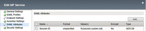

  • Include the session.custom.sid in the SAML assertion as an attribute (e.g., Session_ID).
Final IDP Policy

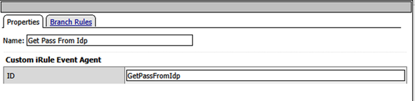

Access Policy Agent Event in the SP Policy:
Assign this iRule to the SP Virtual Server.
when ACCESS_POLICY_AGENT_EVENT {
    switch [ACCESS::policy agent_id] {
        "GetPassFromIdp" {
            if {[catch {
                ACCESS::session data set session.custom.password [ACCESS::session data get -sid [ACCESS::session data get "session.saml.last.attr.name.Session_ID"] -secure "session.custom.password"]
                log local0. "ERROR: Session_id: [ACCESS::session sid] - no custom.password set"

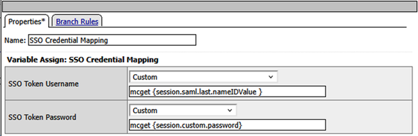

  • Now session.custom.password is available in the SP session and can be used in SSO Credential Mapping.
Note: In this example, we assume the SAML assertion Subject contains sAMAccountName and it’s used directly for credential mapping.

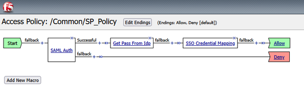

Final SP Policy
