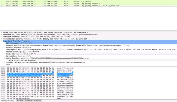

I would suggest that you do a packet capture and look if the client is fetching a kerberos token and presents it to the APM
- Bill_Kehn_27007Nov 11, 2017
I am using IE as the browser, I do have the site added as intranet and enable integrated windows authentication is checked.
I do not see any kerberos traffic in my pcap but I do see what appears to be NTLM.

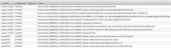

Moving on to the SSO side I am having an issue here still that I cannot figure out. This is what I see in the log now:
I will doublecheck my sso config to be sure and might see if I can get a packet capture of the server side process.

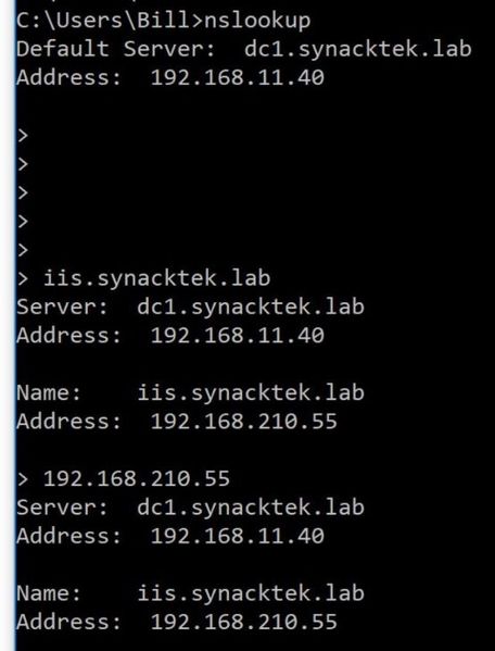

Does the user logon name in AD need to match the reverse DNS of the target IIS pool member?
In other words I have this for the logon name:
My forward and reverse DNS of the pool member IIS server is this:
192.168.210.55 is my pool member of the virtual server.

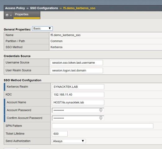

And my SSO configuration on the F5 reflects this user logon account:

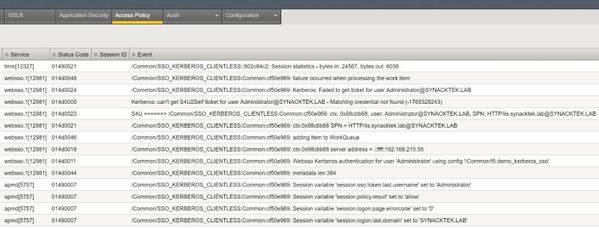

The APM log for sso always shows this:
I do not know why it keeps saying matching credential not found here.

The default SPN used by APM is based on the reverse dns
If you want to use SPN based on Host value, change SPN pattern to
HTTP/%h - Bill_Kehn_27007Nov 12, 2017
Thank you, I may try this. But the reverse dns is what I have configured as the account so that "should" be working. Something with AD or the delegation seems to be wrong but everything I look at appears correct.
