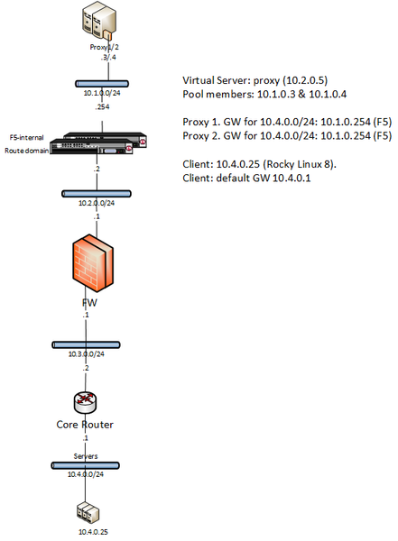

Hello everyone,
Thank you for your suggestions. I have confirmed that there is no asymmetric traffic since the F5 is the default gateway for the pool nodes of the virtual server. Therefore, all packets must pass through the load balancer as the clients are on a different network.
Anyway, I agree with you that if the client-to-server flow were offloaded then I should also not see the ACK or GET packets.
Additionally, I wanted to provide more context for the issue. The problem arises when the SYN Cookie mechanism is enabled on the virtual server. Some servers are unable to connect to the service because they receive a server-reset (RST) packet. I was trying to capture traffic on both the client and the server (F5) to understand what was happening.
If you have any further suggestions or insights, I would greatly appreciate it.
Thank you!
