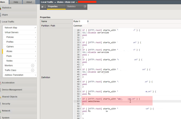

Irule redirect link error to default domain
Hello,
I have a domain abc.com new build, i want to redirect all link old or error go to home page, and all the old links have the same structure.
Exam old link: https://test.abc.com.vn/DetailJob.aspx?Mod=search&CatId=21&job=1029042&Lang=vi will be redirect to https://test.abc.com.vn.
I have created an irule as below, but it does not work. Can you help me, please!
when HTTP_REQUEST {
  if { [HTTP::host] starts_with "test.abc.com"} {
    Pool websitenew
  } elseif { [HTTP::host] starts_with "test.abc.com" and [HTTP::uri] ends_with "Lang=vi"} {
    HTTP::redirect "https://test.abc.com"

    • Tuan_Vu's avatar
      Tuan_Vu
      hello,
      But, i config many site use only IP address. Can you tell me more clearly, Please!

    • Tuan_Vu's avatar
      Tuan_Vu
      Hello Mayur Sutare,
      This is currently my irule configuration, can you tell me what I should do to handle the above question?
      Thank you !

    • Tuan_Vu's avatar
      Tuan_Vu
      Hi Mayur,
      I don't think so, because some of my sites have the same end. So I want to assign a specific domain test.abc.com.
      If I do as you described, it redirects my whole other site?

    • Tuan_Vu's avatar
      Tuan_Vu
      Hi Mayur,
      It not working for me. You have know a other solution, help me!
  • make sure you have new iRule above existing iRule. Also if it is already there, then it seems end statements is not getting matched.
