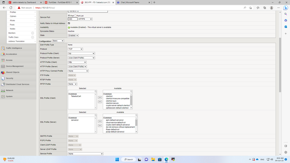

      • MustphaBassim's avatar
        MustphaBassim
        Icon for Cirrus rankCirrus
        Hello Dear
        I did the configruation as shown on picture when TabadulCert is our public certicate
