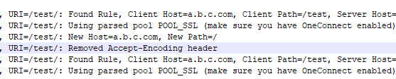

we are using proxypass irule to change pool when uri parameter change , so when user is hitting a.b.c.com/start it going to defined pool in datagroup and
thats working fine. Now we deploy certificates on servers side to secure traffic between F5 and physcial servers, and unfortunately it doesnt work.
We set on VIP SSL Profile (Server) as profilessl , we defined correctly in ProxyPassSSLProfiles datagroup : POOL -> profilessl , and during accessing a.b.c.com/test it response with : server doesnt send any data. It looks like loop , it finding rule but cannot proceed because we not receiving data.

Below debugging from iRule.

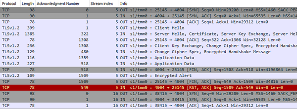

    thank you for interesting of this topic. When I sniff traffic between F5 and physical server it looks like it want use SSL but strange things are happening, because it try negotiate TLS handshake and afterwards server is sending FIN. (we are using port 4004 for this communication ). Worth to mention , when I make this without proxypass its working ...

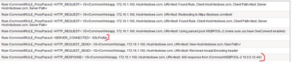

        You are right common/default pool for this VIP doesnt have SSL, output of command on screenshot .
        I had to make own lab and Its strange, I suppose issue with irule proxypass, even when I made two POOLs and each host have 443 enabled I got bad request
        It looks like server is getting requests on 80, But in LTM logs we can see I have matched serverssl profile to pool in datagroup of proxypass, also it is set on VIP (server ssl profile)

        hello boneyard, no, there is SSL communication too, now I testing on production but still not working... so now it looks :
        1. Hitting VIP on 443 is ok
        2. Hitting VIP with /uri which should forward traffic to POOL with SSL is NOK(port 4009), I see handshake to VIP and afterwards it correctly communicate to correct POOL on SSL port but response in browser : ERR_EMPTY_RESPONSE
