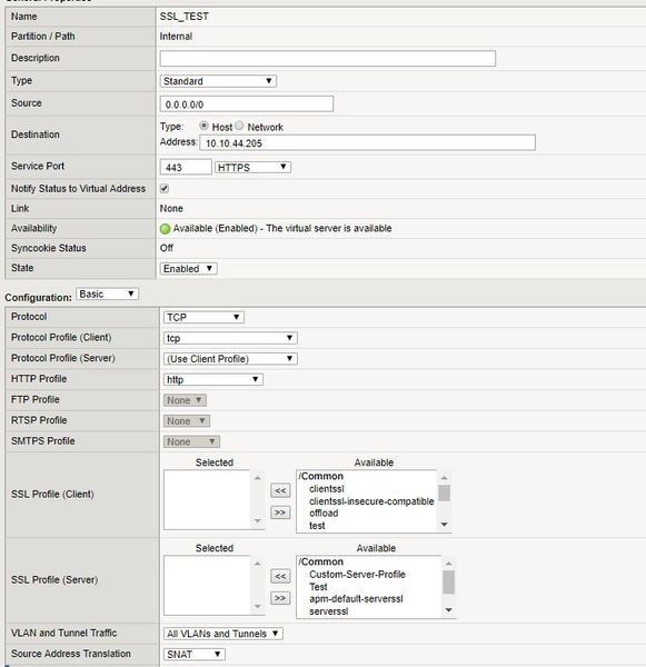

Hello,
I have a standard VS configured to work for HTTPS. There is no client/server SSL profile configured in the VS. But for some reason its not working. But if I change the VS to 'Performance(Layer 4)', it will work. I am wondering why this is so?
Here is my config:
Any help would be appreciated!
2 Replies
  • You may be having fragmentation or MTU issues.
    A FastL4 virtual passes traffic without proxying, so packets on the server-side have the same TCP options as the client side packets.
    A Standard virtual establishes a full connection on the client-side, and the server-side TCP options may be different to the client-side options. This may cause problems with packet fragmentation and reassembly that can interfere with SSL negotiation. You would need to collect a packet capture to be certain about what is happening.
    I'd generally recommend FastL4 virtuals for SSL passthrough, as opposed to Standard virtuals, for this reason.
  • eey0re's avatar
    eey0re
    You have an HTTP profile associated with your port 443 VS. If you are expecting TLS between the browser and the backend server to work, without Client and Server SSL profiles on the VS, then you need to remove the HTTP profile.
