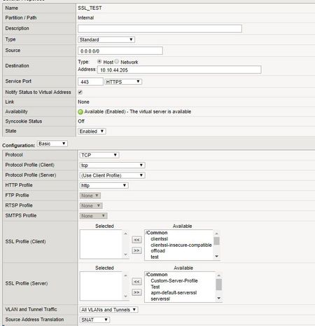

Hello,
I have a standard VS configured to work for HTTPS. There is no client/server SSL profile configured in the VS. But for some reason its not working. But if I change the VS to 'Performance(...

Nov 19, 2017You have an HTTP profile associated with your port 443 VS. If you are expecting TLS between the browser and the backend server to work, without Client and Server SSL profiles on the VS, then you need to remove the HTTP profile.
