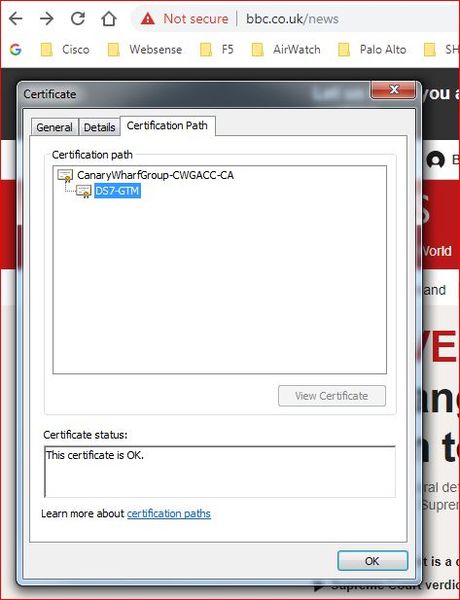

    I tried your suggestion and disabled the SSL Forward Proxy option on the client & server SSL profiles. Now client PCs can connect to internet sites such as BBC, however they get "Not Secure" certificate warning on their browser.
    When you check the properties of the certificate warning on the browser. The Certificate Path shows my Internal CA server cert, then the cert that resides on the F5 LTM (which was signed by my CA server). I think I should see a third cert in the chain (third cert being that of the destination server i.e BBC)?
