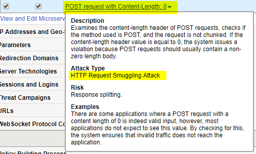

We have implemented ASM recently and one request was blocked because of content length being 0. Checked with application team and as per them that shouldn't be blocked. Is there a way to exclude a URL from this check or is it only global? Please suggest

    It's also good to know that the configuration utility gives hints on what to look for. See the example below.
