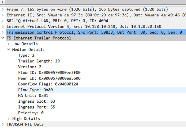

How to match the client-side TCP stream and server-side TCP stream of the same request?
hi : Standard VS config with autoMap, when a client requests will be split into two separate TCP connections, through the tcpdump - ni0.0: nnnp parameters can at the same time get the client-side and server-side packet, How to match the client-side TCP stream and server-side TCP stream of the same request, most of the time I found the source port has changed.

    you should use Wireshark 2.6.0 which includes the F5 Plugin. Activate the F5 protocol filter.
    Lookup one of the streams and read out the flow ID from "f5ethtrailer.flowid". Then apply a display filter f5ethtrailer.anyflowid == [flowid]
    This is essentially the same like ( f5ethtrailer.flowid == [flowid] ) or ( f5ethtrailer.peerid == [flowid] )
    See KB 13637 and F5 Wireshark Plugin
  • Thanks!But it does not work ,I tried it many times. The plugin 'f5ethtrailer.dll' has no "plugin_version" symbol
