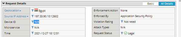

This is ASM event log
Still Device ID field is N/A, Device ID+ configuration should reflect to Device ID field??
Anyone can help what's wrong?

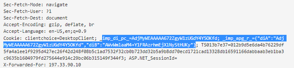

  • i'm able to log diA & diB using irule provided by Anulfo Hernandez
