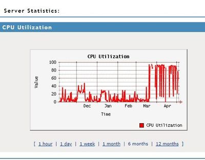

High Server CPU after 16.2.1 Upgrade
 Our SysAdmin team has reported a sharp increase in CPU usage on the nodes in our ltm pools after upgrading to BIG-IP 16.2.1. from 14.2.1. The servers are maintained by a different team, but I can confirm they are running Apache 2.2.27
Has anyone experienced similar outcomes during upgrades?
