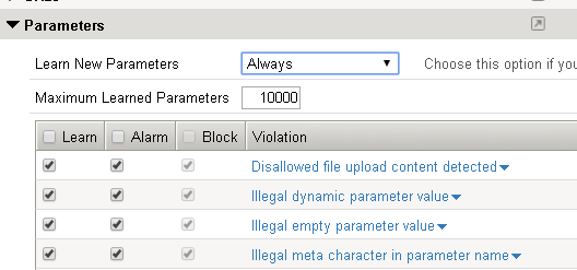

help -best option about parameter learning!!
hello I have a question regarding the learning of the parameters, which would be the best method to use in an implementation never, always, selective, I think that by discarding never is not the best option, my doubt is whether to use always or selective, if I use I will always learn all the parameters that you send in the requests, it is recommended that you learn all the parameters by strain, I understand that if I know how well the policy could eliminate the willcard? , or use select since you only learn the parameters that exceed the willcard, how to define the properties of the willcard so as not to suffer an overflow attack?

    The short answer is (unfortunately) : it depends ! :)
    It depends how strict you want to be on the policy, and how much time you have available for the job.
    Always : once policy is stabilized, wildcard is removed any parameter not in the list will be blocked.
    Selective : wilcard remains, paramters are allowed, but if you have to relax a setting (e.g. disable an attack signature) this will be applied only to the relevant parameter and not to all of them
    Never : wildcard remain, and if you relax a setting (e.g. disable an attack signature) this will be applied to the wildcard, i.e. all parameters.
    So no real "rule" unfortunately.
    Hope this helps in the reflexion ?
