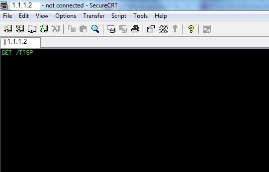

- luyenntk50db
When i telnet IP:port. ex: 1.1.1.2 port 8089. I typed GET /TTSP, and immediately telnet closed - not connected.
- mimlo_61970
Cumulonimbus
Then your webserver doesn't like how you have the request formatted, it probably requires a more complete HTTP request. Try one of the above 2 versions I recommended.
