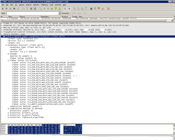

  • Here is the capture when no monitor, the server answers correctly

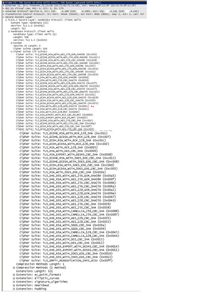

    And here is the capture when the monitor is activated, the server sends back fatal error:
  • I've seen this before. It may be an issue with openssl on BigIP or the SSL stack on your server. In this case, the SSL stack on your server doesn't like the version differences in the handshake envelope. Even though it is "complaint" by RFC standards, I've seen more than one server fail handshakes with this behavior. As you can see the monitor is sending a version TLS 1.2 handshake inside of a Client Hello mark with version TLS 1.0. Your server probably wants those to match. Unfortunately, I'm not sure if there's a way on your end to change that behavior in the monitor.
