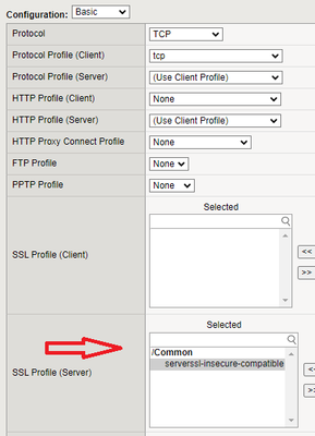

      • emre_ovali's avatar
        emre_ovali
        Hi Muthu,
        Have you try to use server-insecure-compatible SSL profile (Server) at the server side?
