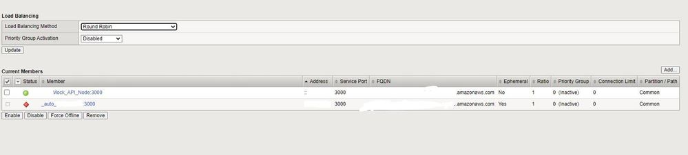

Yes.However our pool has an ec2 node that stays green even when the service is down as seen in the below image.Hence the member check fails.
