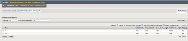

After ASM is turned on, I am not allowed to upload any PHP files. Where do I need to turn off this feature to upload PHP files?
5 Replies
  • I have added the allowed file types, but the upload is still blocked, what should I do? Is there a place in ASM that can limit the file upload extension? Is it necessary to modify it there?

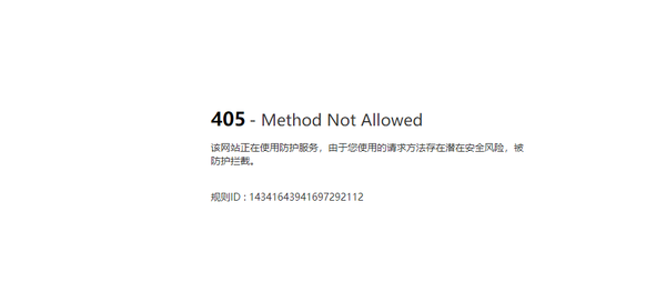

  • You can find for details what is blocking, please check your support ID in the blocking response page.
    Could you share the event logs for details?
  • First, did you set logging profile on VS?
    Second, try to changes on transparent mode, if the result still go to blocking it shouldn't because asm policy.
  • Method not allowed - that looks like your server declined the file upload - rather than the ASM blocking it. The ASM response page does not (by default) reveal a reason why it was blocked.
