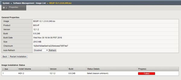

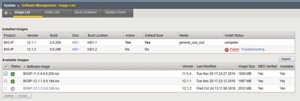

I have a problem about installation BIG IP Operating System. Before that, I have been "md5sum" The BIGIP-12.1.2.0.0.249.iso and "Cat" the Hotfix-BIGIP-12.1.2.2.93.276-HF2-ENG.md5 and same and have been verified. But, when I start install the BIGIP-12.1.2.0.0.249.iso, appear the failed instalation, like this pics:
Every one know how to solve it ?? Thanks so muchh .....

    have you checked below
    tail /var/log/liveinstall.log
  • Which version of F5 Hot-fix has installed previously on HD1.2? This kind of error occur when F5 partition doesn't support latest software. I have observed issue once when upgrading v10.2.4 to 11.5.X.
    My recommendation is to delete HD1.2 & recreate HD1.2 during installation. Hope issue will solved.
    • Satriaji's avatar
      Satriaji
      Icon for Cirrus rankCirrus
      Thx for your advice and I also have been do it, but its same ...Failed. I found out this article and I try this way .. and its work ...
      https://support.f5.com/csp/article/K13117
      The conclusion is adding the ".sig" in local shared/image/... using winSCP.
      :)) Thx so much .....
