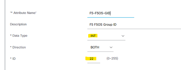

We are going through a hardware refresh and starting to deploy fSeries appliances. I am having issues with Radius authentication with our Cisco ISE deployment. Our current LTM's authenticates to the same ISE deployment and has the AV attributes for LTM applied. I have created the following new dictionary entries and assigned them the authorization policy:
F5-F5OS-GID = 9000
F5-F5OS-HOMEDIR = /tmp
F5-F5OS-UID = 1001
If I login to the F5 via the admin creds I can see that my radius authentication was successful and I can see the at the AV Pair is being presented via ISE logs.
When trying to login via a browser and a radius user I get a Permission denied response.
Any assistance would be appreciated:
Thanks,
Joe

I open a case and was able to resolve this by using the proper "Data Type" and "ID".
This was the response from support:
F5-F5OS-UID: type 21, integer, value 1001
F5-F5OS-GID: type 22, integer, value 9000
F5-F5OS-HOMEDIR: type 23, string, value /tmpHope this helps others
Thanks,
Joe
