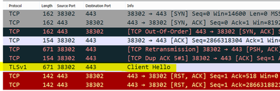

4. Im seeing F5 using TLSv1 protocol for 'Client Hello' in PCAP and server is not responding with 'Server Hello', Server send RST message immediately.

      >> Server has Cert associated with Website. F5 sends 'Client Hello' but no server hello at all. Question is why F5 is sending via TLSv1. PCAP attached. After F5 sends Client Hello, 'SERVER' is sending RST as you see.

      • See, in the Client Hello packet includes the list of protocol and ciphers that the client supports. My suspicion from the things you wrote above would be that the device (F5 BigIP) does not support the ciphers that the server requires.
        Perhaps you can confirm this by checking the server config or run the tests from a functioning client and determine one of the supported ciphers from there. If you have no functioning client perhaps looking at the server SSL config would be in order.
