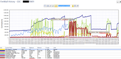

We're facing for quite a while, some sort of a DDoS tries (I can't consider it as an actual attack), against our F5 Public DNS.
Initially we were seeing ~700K - 1Mil connections (IP connections) and after some analisys we decided to lower port UDP 53 timeout from default 40sec to 10sec (on our firewall that is in front of the F5). That change had an positive impact on peak conenctions (when DDoS was seen) by lowering them to under 50% - appros 300-400K connections nowadays.
At this point, we started to collect data and we've seen that there is a pattern on this DDoS (at least once a day, and close to the same time - almost) and also we got the IP's that are performing those querryes (top 10 IP's based on conenctions performed in that moment).
The missing piece was the actuall querry that was performed during the HIGH connections moments, and for that we enabled F5 DNS logging, but having too much traffic, we could only see 10 - 15 sec in F5 logs ğŸ˜” .

      2. UDP timeout can be immediate. When flooded, UDP acts almost like streaming video.. it will blow up each connection as wide as it can and then take every connection possible. You end up with port exhaustion and eventual collapse. Make a new UDP profile and apply it to your DNS VIP(s). - that was the first thing we did back in June/July when we noticed the events. As you see in the below screenshot, by lowering the UDP 53 from 40 sec default timeout to 10 sec default timeout, we are now facing ~350K connection (while initially we were with ~1.2Mil connections) . The UDP 53 timeout was set on the Firewall, that is in-path between Internet and F5 GTM .
