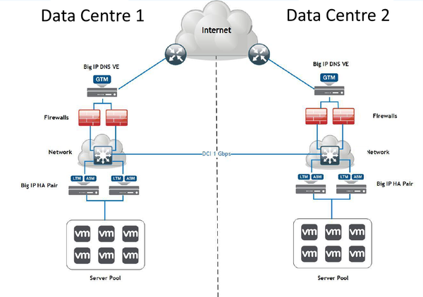

I have a new deployment, a pair of HA F5 LTM (Physical) and VE F5 DNS at each site. Configured as per this diagram:
I have the LTMs working and configured as I need them and these are working perfectly fine.

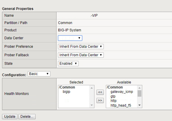

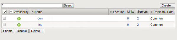

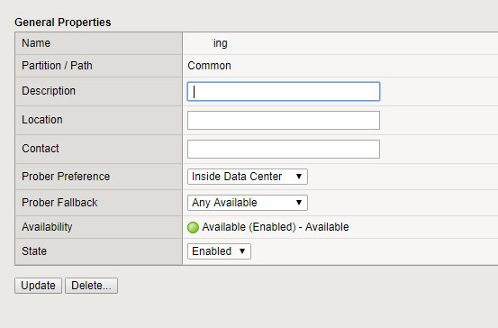

Regarding the F5 DNS I have setup the following;
  • GSLB -> Data Centres ->
  • DC1 Setup
  • DC1 Servers

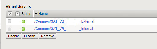

  • DC1 - LTM - VIP
  • Virtual Servers - Discovered
  • No Links discovered though?
